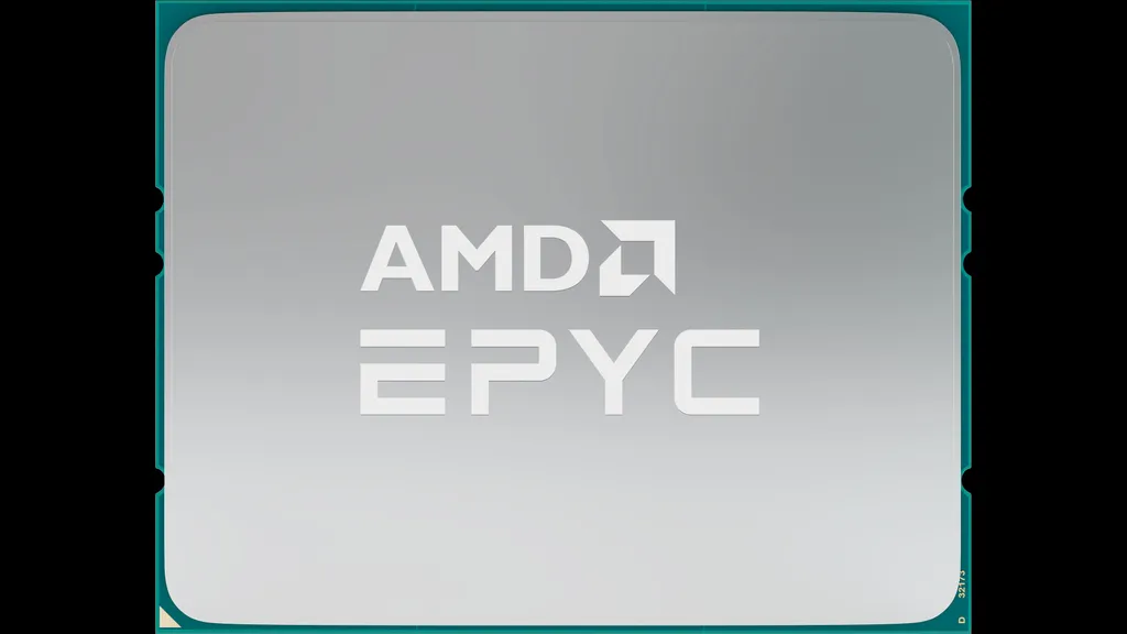

AMD today announced an extremely ambitious goal: to reach thirty times higher energy efficiency of its EPYC CPUs and Instinct GPU accelerators by 2025. AMD itself knows how lofty a goal this is: the aim surpasses typical industry-wide efficiency improvements by 150%.

AMD has set a baseline performance measurement with the aggregate performance of an existing system (compute node) with four MI60 GPUs and one EPYC CPU (unspecified model). This has been defined as the baseline "2020 system." AMD will measure milestones with new generations of server nodes with the same number of GPUs and CPUs.
